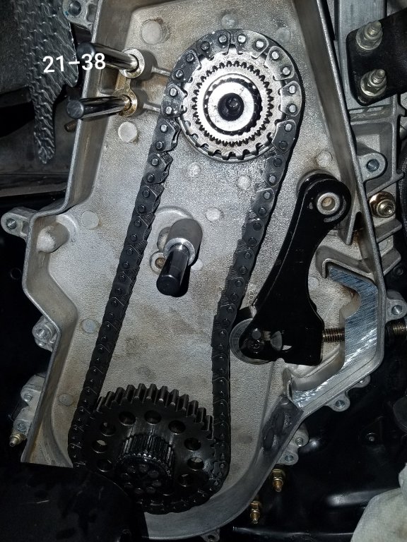

21/38 = 1.81 ratio. A 21/37 (1.77) will fit but big larger dog-leg. 1st pic 21/38. 2nd pic 21/37. Both with 84 pitch chain.
If you keep chain at correct tension, 22-37 works. If you don't watch chain tension, then likely you'll get chain rubbing on center post. NFG.

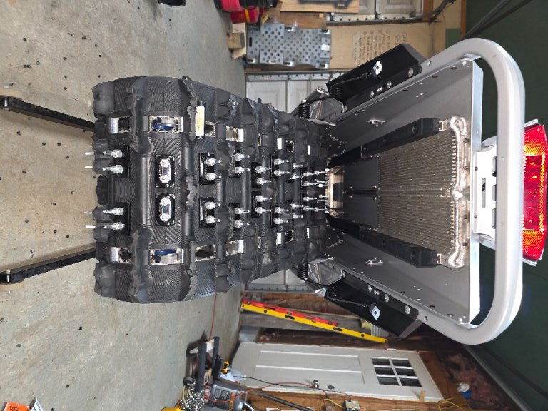

Update so far. Studded center of track. 192 mega bite. All doubles. STM tunnel protectors. Added BRP rear scratchers. Fit nicely under the tunnel flares when not in use. Hurricane gold charge tubes. 4th wheel kit installed with Barn of Parts plastic deletes kit. LJE trail courtesy light.
Next up will be scaggs. Big thanks to my Brother in law and Father in law for the help.
