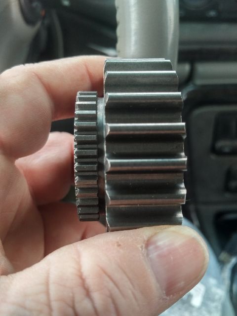

Posting this so its easier to find for everyone.
Just got it installed here, it fits with stock chain....alot easier if you have some miles on chain for abit of stretch.
Arctic cat part # 22 tooth top gear: 1702-395
$19 bucks US, $25 or so Can. http://countrycat.com/ccstore/index...2-395-sprocket-bw-22t-rev-15w-w-brg-assy.html
Dan
Dan

Those are some GREAT lOOkinG HANDS LOL. QUOTE="ROCKERDAN, post: 1352732, member: 3126"]Posting this so its easier to find for everyone.
Dan
View attachment 126376 View attachment 126377 View attachment 126378 View attachment 126379[/QUOTE]

Nice manicure Tom! hahaThose are some GREAT lOOkinG HANDS LOL.
