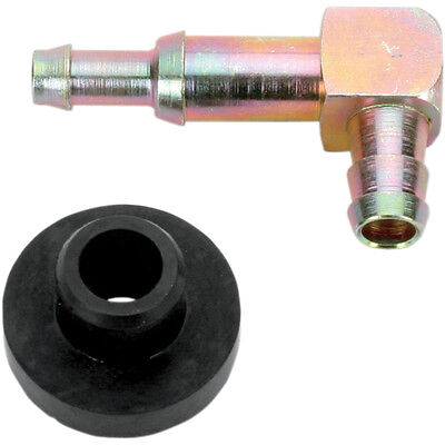

If you feel the need to use 5/16 fuel line get a metal fitting made for 5/16 line. As I said above the metal style fitting hang further into the basket/tank.I see some guys saying they are using 5/16" fuel line to run to the new return location on the pump. That size appear it will fit fine on the fuel pressure regulator but would be too large for the plastic elbow fitting on the other end. What are you guys using to clamp that end down if you are using 5/16 hose? The plastic elbow fitting is made for 1/4" hose.
jonlafon1
- Aug 18, 2014
- 4,302
- 3,348
- 2022 Sidewinder LTX_SE
2024 Catalyst RXC
Fuel Elbow 5/16" - 90 Degree Tank Fitting Metal with Rubber Grommet 2105-1000 | eBay
Lawn & Garden. Personal Watercraft (PWC).
www.ebay.com
