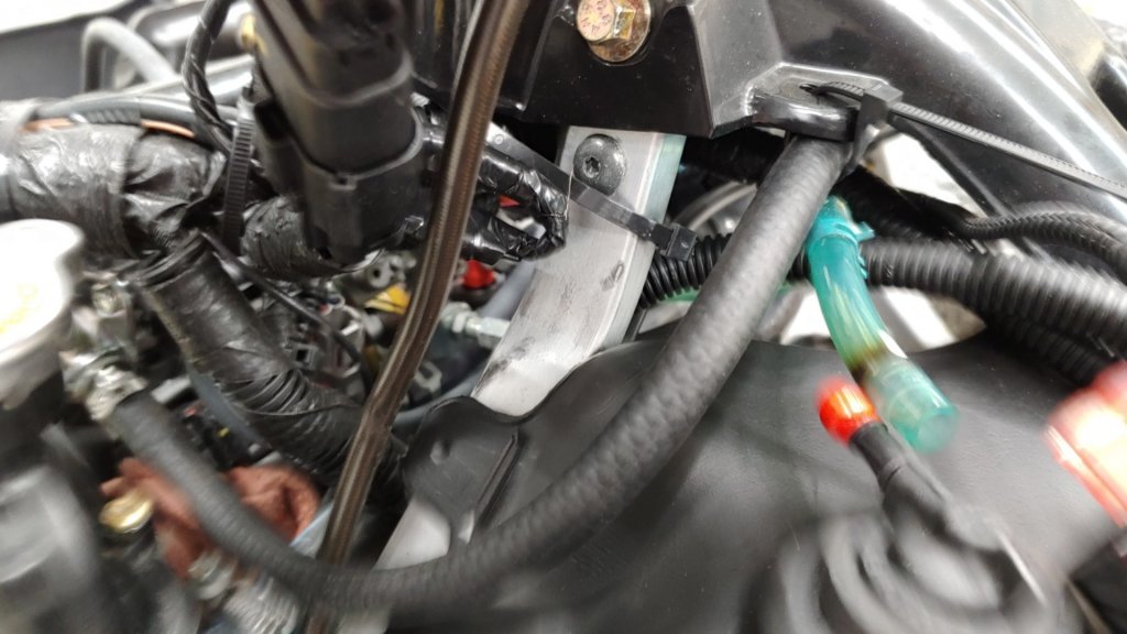

Got mine done today. Ended up not using the SAE J30R7 hose and buying some SAE J30R9 hose. The 30R9 hose has a thermoplastic liner (or something like that) so it won't harden with the ethanol in fuel. That hose was much harder to put on the fuel pressure regulator but I got it on by heating up the end of the hose and spraying a little WD-40 in the end.
jonlafon1
- Aug 18, 2014
- 4,302
- 3,348
- 2022 Sidewinder LTX_SE
2024 Catalyst RXC
Looks good!Got mine done today. Ended up not using the SAE J30R7 hose and buying some SAE J30R9 hose. The 30R9 hose has a thermoplastic liner (or something like that) so it won't harden with the ethanol in fuel. That hose was much harder to put on the fuel pressure regulator but I got it on by heating up the end of the hose and spraying a little WD-40 in the end.View attachment 164232View attachment 164233View attachment 164234

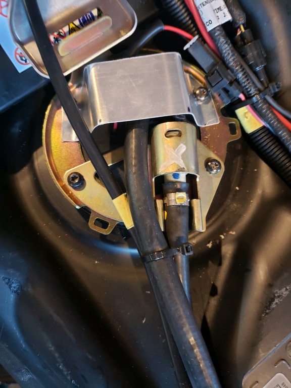

Since people were concerned if the plastic elbow and grommet would stay in the top of the fuel pump assembly, I made a safety gaurd.
Even though I ran this for one year with no issues.
The wires do not rub on gaurd.
As hard as it was to get the elbow pushed into the grommet when using a 1/2" hole (instead of 0.52" like the one in the stock location, it would seem unlikely that the elbow would pop out of the grommet. Regardless, I may make a guard similar to yours.
HABS 1
- Oct 22, 2015
- 602
- 118
- 828
- corunna,ontario
i dont think it will pop out , if anything i think it would cut the wall of the grommet makin it 2 pieces , then that would be not good! i only think this because i added a gerry can tank to my gas generator and put this exact fitting in the bottom on the jerry can to gravity into the extenda run cap on the generator, and it split after a few weeks, i then put a bulkhead style fitting in it compatible with fuel much better , but there is no room to use that style on the winder
