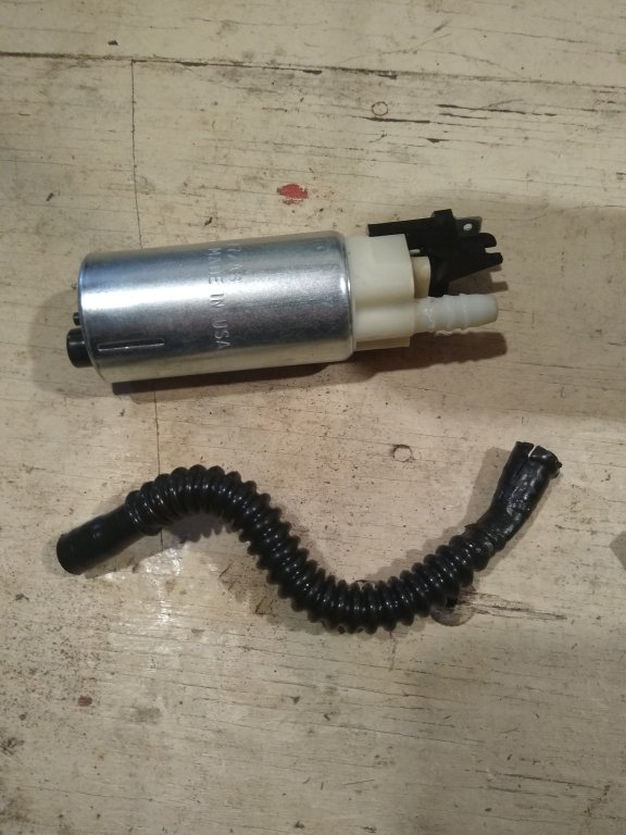

Well ...I fellow member gave me perfect instructions on how to save the outlet hose. And well....I shedded it.
I'm hopeful to get away with 5/16" high pressure fuel line. I'll keep it straight directly from the nipple on the pump to the nipple up top. Thoughts?!?!
Turboflash, Thanks for your insight. This one's the real deal. All metal G/rotor. Positive and negative are not marked. I'm hoping to position it like the stock one and everything is the same?!?!

Here you go for wiring.

Thanks, Tim!!Here you go for wiring.
I just ordered that piece of flex fuel line. Wasn't bad. Be here Wednesday.

Oh my.... Mine didn't come out that nice. Lol. Great work!!!
I believe thats PEFIs fuel upgrade kit...very nice.

mine was wired like that from TD, ... it vibrated loose one trip and was surprised i never blew up cuz im sure it would arc in side the tank...soo i got the proper dual connector that locks in off amazon and soldered the wires. now i know its safe.Here you go for wiring.

You can buy a modular fuel pump plug for the whalbro pumps from Amazon. Locks in real good to the pump. Has pigtail wires coming out. I soldered the wires to the original factory pump wires with heat shrink over the jointsmine was wired like that from TD, ... it vibrated loose one trip and was surprised i never blew up cuz im sure it would arc in side the tank...soo i got the proper dual connector that locks in off amazon and soldered the wires. now i know its safe.
