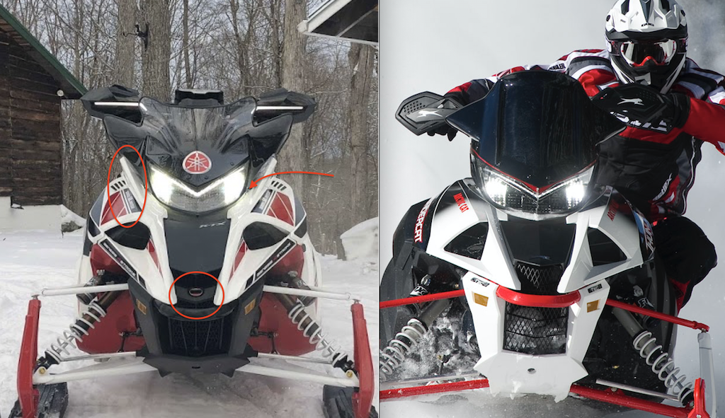

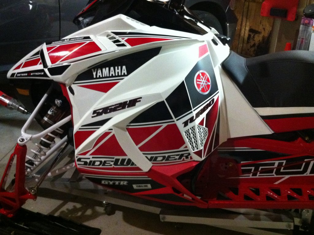

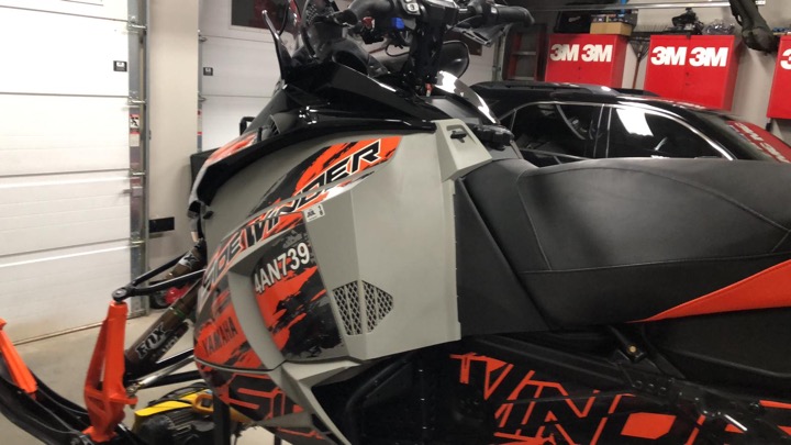

Many differences from winder to 9000....Viper plastics are basically same as pre '17 cats....those were horrible, much like my '12 procross.
Winder and 9k both have the LED signature light, and LED headlight. Same chassie, and same gauge package and mounts. Same lower panels(lft&rt) and same lower front panel, same bumpers ect...Much is same.
Differences are actually alot in the plastics...Winders IMO have a much nicer look. They are also warmer plastics. Winder uses two wings on either side of the window, which works into the side flares of the SE window, all making for much warmer mid section compared to cats narrow windows(no side flares whatsoever) and NO side wings.
Because of this, the winder side panels are much trickier to close, since we have the tabs on top that need to snap in, Cats simply close panel and turn locks, done. So cats panels open/close much simpler. Same two tabs at bottom tho on each sled.
I have seen a cat add a SE window, as the SE window is easily the warmest window that also looks good. Most others that are warmer are quite tall and lose the nice look and flow of the lines of these sleds. Cat windows are narrow and all painted so you lose peripheral vision, and colder due to narrowness. Winder windows use tabs that snap into those side wings, the tabs come down along sides of headlight, cats have none of this. For cats to add the SE window, they need to add two black screws to those tabs, into the black panels which are not hidden on the cats like winders are. But it looked great and these tabs are needed IMO to lend strength to the ears of SE window.
Dan
You can plainly see how much more width the SE window has, and how side wings throw air around rider...The winder plastics are very nice looking when compared side by side to cat IMO.
Notice how tab of window goes into/under side wing
Side wings help to throw wind around body, cat has nothing there.
SE window....side flares and curvature at top works well for wind, yet still low enough to look good on this chassie.
