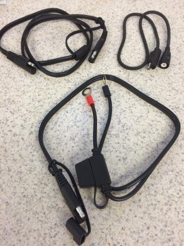

If you want a plug & play solution for a fused cable that will go from the battery to the handlebars here is a picture of what I ended up using.  I found these three cables on Amazon.  One is the fused cable that has the +/- terminal rings on one end and the SAE connection on the other.  The second one is a 36" SAE to SAE extension cable.  The third one is  a SAE to RCA jack cable.  Simply plug all three together.

I wires my heated visor cord right to the battery. I had to use two cords.
I also put an in line fuse.

If you are going to do that, Just put a plug in the plastic with a cover for when you aren't using it. Would make it a nice clean install.If you want a plug & play solution for a fused cable that will go from the battery to the handlebars here is a picture of what I ended up using. I found these three cables on Amazon. One is the fused cable that has the +/- terminal rings on one end and the SAE connection on the other. The second one is a 36" SAE to SAE extension cable. The third one is a SAE to RCA jack cable. Simply plug all three together.
