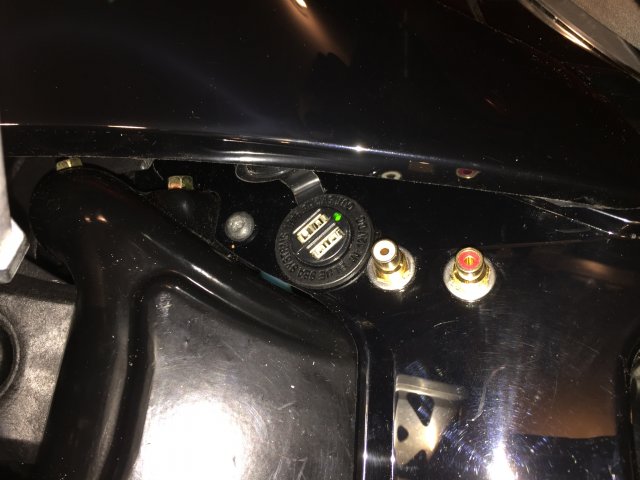

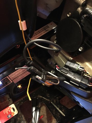

I used the same adapter as Zampinator. I got the three prong adapter so I could have the helmet adapter (used a Y adapter to have two helmets for when my son rides with me) plus a plug for the GPS. I got a plug online for that and put it in the dash too, as you can see in the pics.
I'll add that if you do this, be very careful that your wires aren't rubbing anywhere. If they get a short, it will blow the fuse. The same fuse as your dashboard and your tail light. Then you are left riding with no gauges and no light... and of course a foggy helmet. Ask me how I know...
