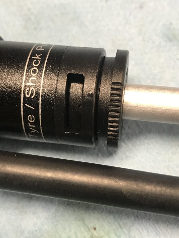

Just turn this clockwise
Thank you. I guess I wasn't turning it hard enough. What I can't believe is the mechanic at a well know dealership that tried to pump up my shock did not know this.
My experience with the Dualstage pump is the big pump is only good for 50 psi max then you have to use the regular one. So it does save some time but wish could get more out of the bigger one.
I agree. Tried using the larger pump with the same results. I still cannot get over 255lbs.

You got something going on with your shock, you should be able to take it to 300psi with no problem.I agree. Tried using the larger pump with the same results. I still cannot get over 255lbs.
Even the dealer could not get it past 255lbs.

You will have to have a shop look at it, its being restricted, if possible get your dealer to give you another one to try you should have some warranty on the upgraded shock, i'm running 280 in mine had no problem at all reaching that pressure.
Sled is in the shop at ths time. Will ask the dealership to try this, thank's.

I agree with 20/80 as I've been running 275lbs in mine before and after Cannondale's shock refresh but have since lowered to 250lbs.
Dealer is looking into it, thanks

Let us know how you make out.Dealer is looking into it, thanks
I will when I go up north to get it.
