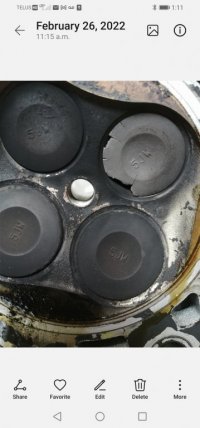

I have changed many chains on various ATV/Motorcycle engines over the years as the teeth, holes and pins wear. Just not this engine yet, but I have a 06 Vector here that is coughing back through the intake a bit at idle, and not running good. Suspecting chain may have jumped a tooth.

Found my trouble
So is that the Vector, or the Sidewinder?
- 5,498
- 4,166
It's an 06 Vector with 19000kms, I suspected maybe cam timing was off, but wasn't.So is that the Vector, or the Sidewinder?
I know, getting off topic, but thought I'd share what I found.
Everything else looks fine. All stock sled.

wow cam would run fine no cough or back fire
