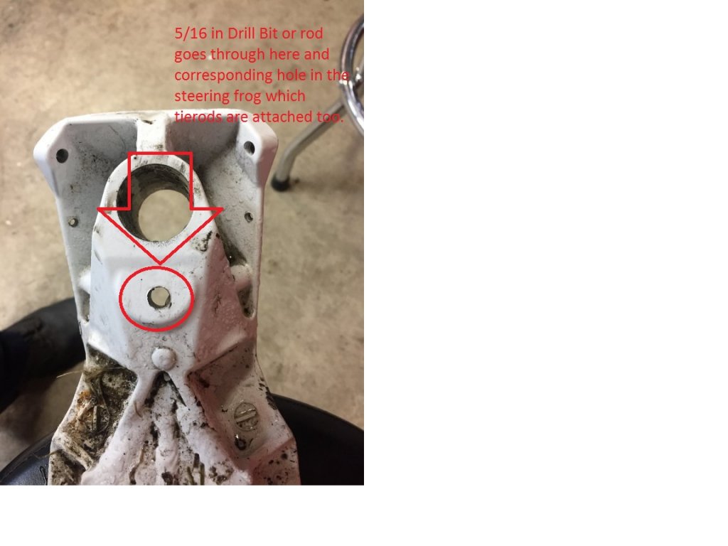

If memory serves me right there is a turnbuckle between the post and the Steering frog which tierods are attached to. There is also a hole in the frog and the frame. If you stick a rod or Drill bit in that hole the skis will be straight and then you just adjust the turnbuckle to get the bars straight. No need to adjust the ski alignment as long as that is correct. Doing it this way also ensures that both tierods have same amount of thread in them in them. Look in the boots at the mechanism before you go adjusting the tierods.

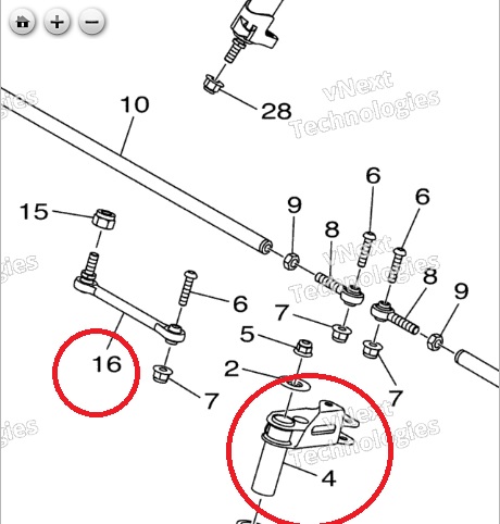

Looks like they deleted the turnbuckle in Sidewinders. So you are in fact left with no choice but to adjust tierods to get you bars straight. Shame they did that.
