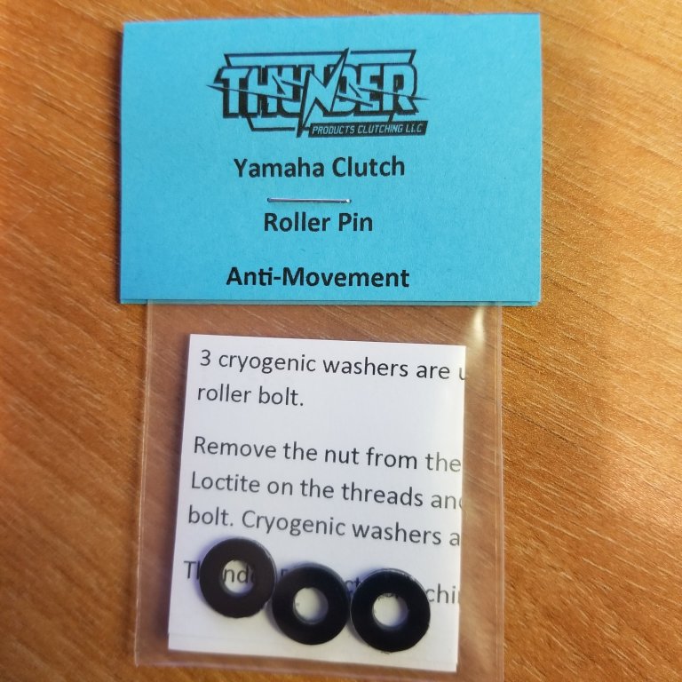

The clutch you have is just as strong as the 2006-2010 clutch. Besides the little set screws for the roller pins removed, there is no other difference in the clutch or how it performs.
The only thing I would do is add our anti-movement washers to the roller pin bolts. This will keep the roller pin and bolts from moving, wearing and making noise.

I don't see these on your website yet.

Our web guy is on vacation for gun hunting and these we just introduced 2-3 weeks ago.
Call us and we can get these out to you.
The part # is TSK-545 and is not on the website yet. They are $5.00 US for a pack of 3.

Thanks for info and reThe clutch you have is just as strong as the 2006-2010 clutch. Besides the little set screws for the roller pins removed, there is no other difference in the clutch or how it performs.
Thanks for info and will be purchasing these and other items from you.The clutch you have is just as strong as the 2006-2010 clutch. Besides the little set screws for the roller pins removed, there is no other difference in the clutch or how it performs.
