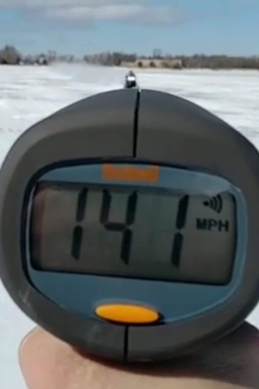

Awesome That’s flyingTried different gear combos with the 17 Winder with 330 TD tune fastest in 1320 was 141 MPH conditions Mint, Ice Hard, and sled dialed in purfect.
22\37 129-134
24\37 134-141 Numerous 140 Runs
