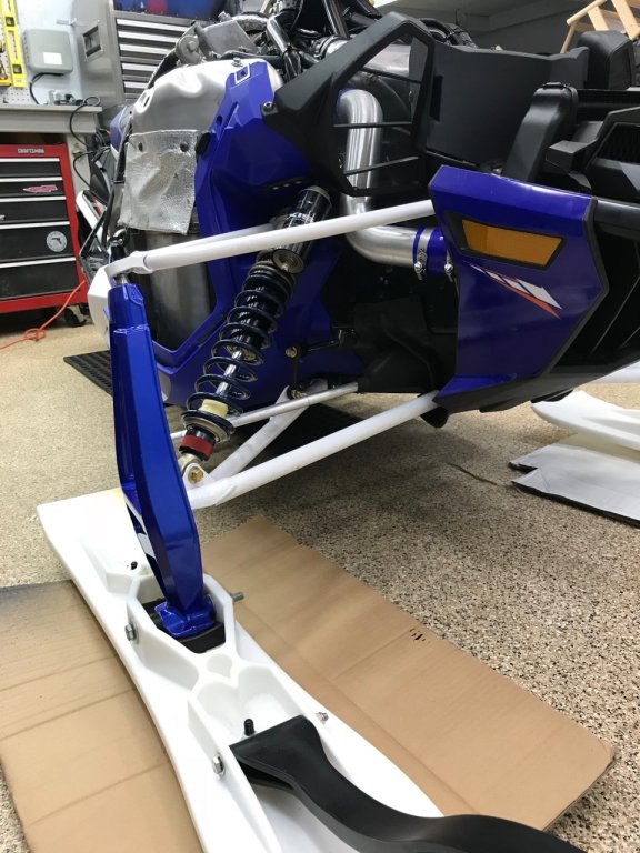

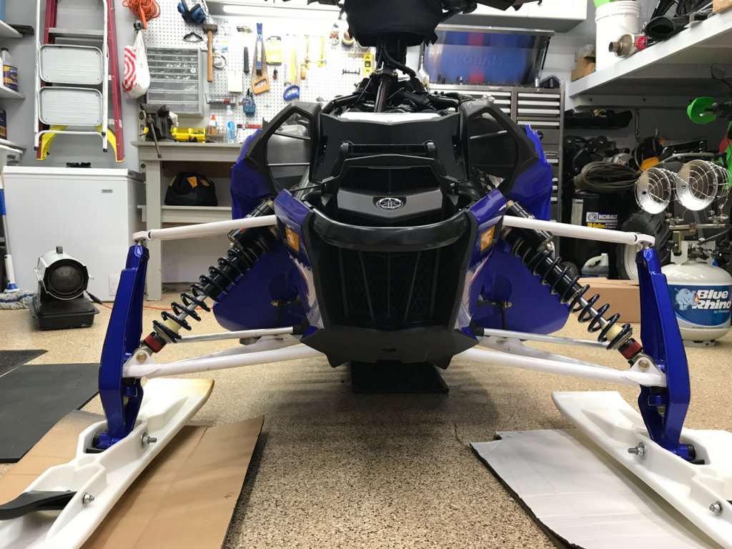

Got all my new Axis shocks installed and set it on the ground. The rear feels SUPER plush.
Those of you who know what you're doing - does the front look too low to you? This is how they came set up, which is how Hygear suggested I start. I might give them a call tomorrow and just confirm it's not sitting too low.
Its not too low. Start there. Springs will settle a little too. Should be about perfect then.Got all my new Axis shocks installed and set it on the ground. The rear feels SUPER plush.

Cool! Steve, thanks - I was hoping you'd chime inIts not too low. Start there. Springs will settle a little too. Should be about perfect then.

They come set at a middle ground. Measure 19.5” to of front bumper. That’s the “stock” procross ride height.

19.5" to "top" of bumper?They come set at a middle ground. Measure 19.5” to of front bumper. That’s the “stock” procross ride height.

Dude.. Ride it... Looks great... After everything takes a set you will have to fine tune... That's why you got them... Ride and adjustment...

Art, I would say that the level of your a-arms are spot on. I can't offer any advice on measuring your bumper height from the ground since the front of my bumper had to be cut off to install the Racewerx bumper.
Hopefully this pic will give you some idea of the height of my a-arms with the Custom Axis shocks:

Bottom A-Arms look about the same, sj's advice is spot on.Art, I would say that the level of your a-arms are spot on. I can't offer any advice on measuring your bumper height from the ground since the front of my bumper had to be cut off to install the Racewerx bumper.
