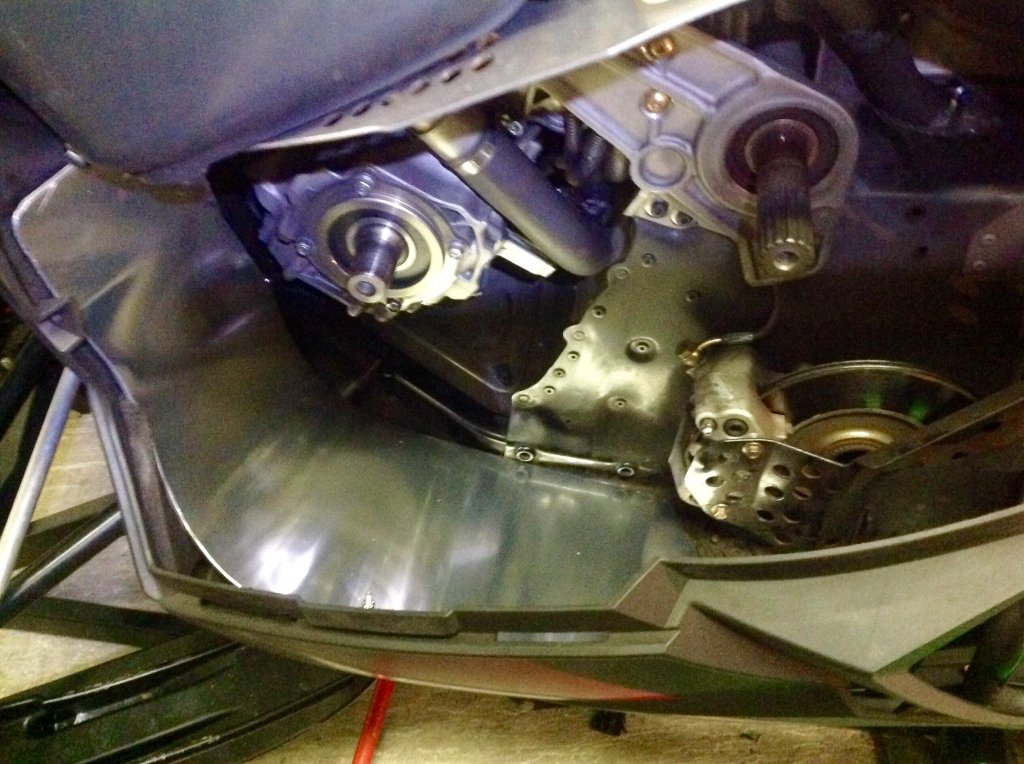

This might be a good thread for us to start posting up who is gonna be making a belly pan protector!!
I dont want to worry about damage to panels if a belt goes at hi speed.
I think I ran across one on Ebay for belly panel protection, but I believe there is a guy here making one too, he made the Power steering kit.
This is something that should be stock from factory on sleds with this much HP
theres lots of belly pan protectors for sale. I got so lucky smoking at least 5 belts with no plastic blow outs last year, I better not push my luck this year.
