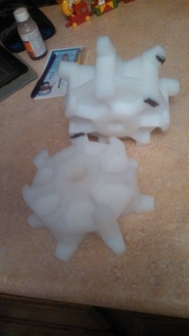

You'll love the PC. Last year on my '09 I switched out my Mav to a CE 153x2.5 and would never run a maverick on any sled again. When you switch out tracks, get some 7t Avid drivers also. Can run your track looser and not have to worry about ratcheting. Then you'll be able to feel the full benefits of the track and turbo.
Cool build. Interested to see how it all works on the snow.
I was wondering about the drivers when I switch the track out. If the drivers are fine I might just leave them for this year and change them out next summer. I actually didn't have any issues with ratcheting last year but I do see the benefits to running the track looser! We already have a trip planned to the UP for early December (as long as there is snow) so I'll burn up the Mav on that trip and give the sled a full shake down.
The stock drivers on the SE Nytros are Yamaha's version on an extrovert driver. They work just like Wahl Bro's which is what I am using, but are significantly heavier because they aren't one piece. If they aren't worn to the point of replacement, I'd wait a year. But then again, you have to pull the axle out anyways, so why not just do it all at once?
What's the typical price for a set of drives and which ones do I go with Wahl or Avid? I know I can check that out myself but just don't have the time right now and it's always interesting to hear what people say. Ya that's what I'm trying to decide on right now. Since I'm going to have it all apart to change the track why not just do the drives as well.

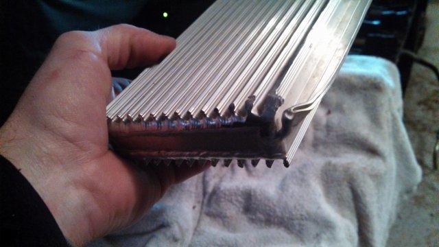

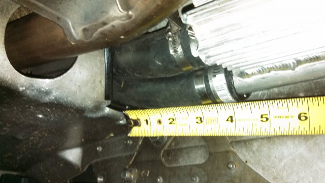

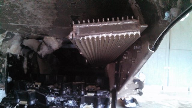

8) MPI heat exchanger (full rad delete) with cable scratchers down ran at 154 degrees on the trail and when I got into the pow she dropped into the 140's. The temp sensor is plumbed right into the T-stat housing. The one issue I did have with the cooler was my track hit the rear of the cooler just a little bit (see picture).

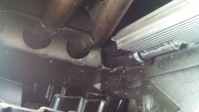

Now when I installed the cooler the directions were very poor and Matt at MPI even told me that himself so I but it were I thought it would be fine. now I am running a Push Turbo and the tolerances are tight but the cooler will fit, I just didn't mount the cooler far enough forward the first time which caused the track to hit. So I relocated the cooler 3-1/4" farther forward (not sure why I didn't just do that in the first place) and now it should be fine. Here's a picture showing the new location. The front of the cooler is about 4" from the front of the tunnel.

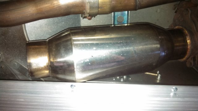

The cooler is close to the header and silencer but it's rock solid and isn't moving.
Overall the coolers construction and finish is top notch but it is a tight fit with a Push Turbo.
