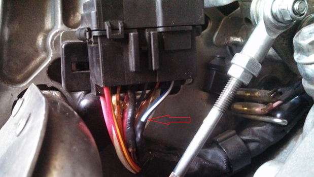

I'd recommend wiring your gauges (+) connection into the blue/white wire coming from the load side of the 20A headlight fuse. Strip some insulation back, solder your wire to the blue/white wire, and then tape / heat shrink everything up good. I also ran a separate 5 amp in-line fuse on the power lead for the gauges. Your (-) connection can go directly to the negative terminal on the battery (use a suitable ring terminal on the end of your wire.

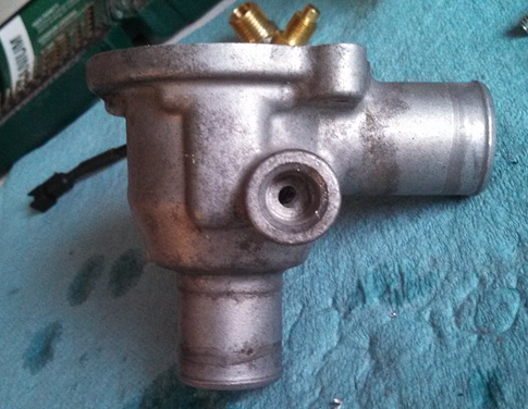

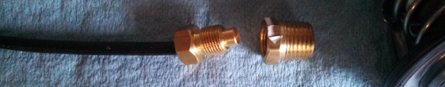

I located my Temp Sensor directly into the Thermostat housing. There is a molded port on the housing that will need to be drilled out and then tapped for your temp sensor. I needed to use a brass bushing (1/4 NPT x 1/8 NPT) for my sensor to fit into the housing, depending on your sensor this may or may not be the case.

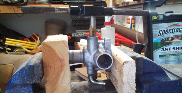

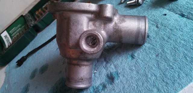

Drill a small pilot hole directly in the center of the port all the way through into the T-stat housing.
Now start increasing the size of the hole until you get to the size needed for your thread tap. I had a ¼” NPT so my final size was 7/16”.
Now tap the port for your sensor of bushing. I used a ¼” NPT. Be sure to make the threads deep enough for your sensor to thread all the way in.
Now thread your bushing and or sensor into the housing and remember to use Teflon tape.

Hi, I have a 08 Nytro that I'm building with a Supercharger. I have mounted a Koso X2 and need to know which is better. I wanted to mount to ignition switch as per instructions but couldn't get it to work right with the ignition switch. You state a bue/white wire is where to connect the white power lead from the Koso. Did you consider the red/white wire in the cluster in wire harness? will the Koso boot up and shut down properly when key or kill switch turned off?

When you wire all your powers to the blue/white (master switched power lead & remember put a fuse on this lead) your gauge will power on & off with the ignition. Now the sled must be running to activate the gauges & not just in the run position if I remember correctly. I'd have to re-look at the wire diagram again to see what the red/white wire is powering but I believe I didn't use that wire because I didn't want to over load that circuit. Let me know if this helps or if you need more info let me know.
