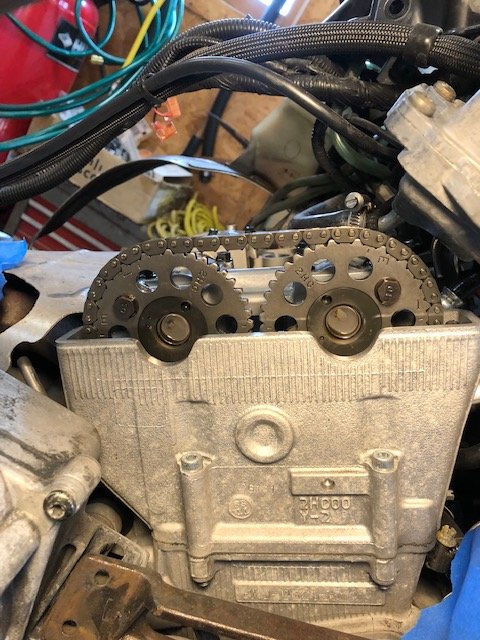

Did the cam timing inspection and it looks OK. Seems to be 1/2 tooth off but there is no such thing !
See the attached pics.
Top of compression stroke is the one that does not show the 2H0 numbers on
left cam.
Other pic is next rotations at the timing mark!
left cam.

So now I can rule out cam timing, and while I was in there, I also checked the valve clearance, that was also OK!Did the cam timing inspection and it looks OK. Seems to be 1/2 tooth off but there is no such thing !
left cam.
