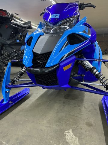

I liked the grill on the '21 ZR 9000 I got, so I compared the part diagram to the diagram for my '20 SW and found that it looked similar enough to just bolt in. It does. Don't even need to remove the hood. It's one T25 torx screw and that's it. CountryCat SKU is 7606-117.

I've been using a cat grill since they came out. Looks much better and easier to clean the snow out.I liked the grill on the '21 ZR 9000 I got, so I compared the part diagram to the diagram for my '20 SW and found that it looked similar enough to just bolt in. It does. Don't even need to remove the hood. It's one T25 torx screw and that's it. CountryCat SKU is 7606-117.

Cat grill plus Frogskinz is #essential.

Just ordered one to try. Looks good.
