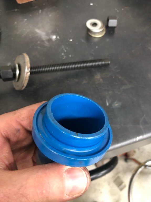

I pressed in with a contraption I made I put seal on blue installer with threaded rod threw it washer on track side of chain case tighten up till seated flush worked really nice

Ok i see what ya did there good thinking. I'm gonna put the seal in the freezer and heat the chain case with heat gun hopefully that will help. I think your on to something there kinda pressing it in instead of trying to tap in with a hammer.

Don’t hammer it in you will possibly cut seal edge we’re meets the case. That way I kinda showed you works really good and also put bear in same way. I hope this helps you out because I was in your shoes I did 2 winders like this worked out good. Keep me postedOk i see what ya did there good thinking. I'm gonna put the seal in the freezer and heat the chain case with heat gun hopefully that will help. I think your on to something there kinda pressing it in instead of trying to tap in with a hammer.
