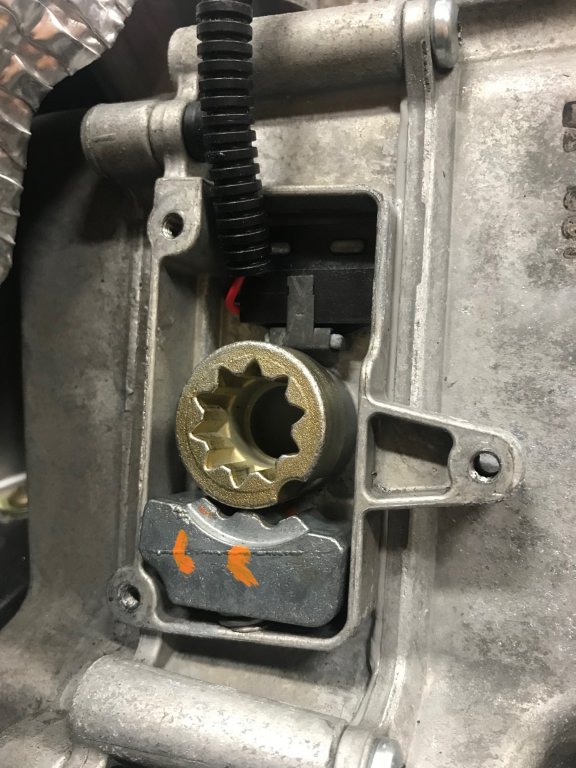

Also, check out the pictures from when I removed the reverse actuator/detent/etc. It looks like it wasn't installed correctly when I compare this to what the service manual shows. Look where the extension is in relation to the detent block. I understand the process to put this back together, it just seems like it wasn't done correctly at the dealer... Am I right about that?

That's too loose and that reverse detent is totally wrong.
