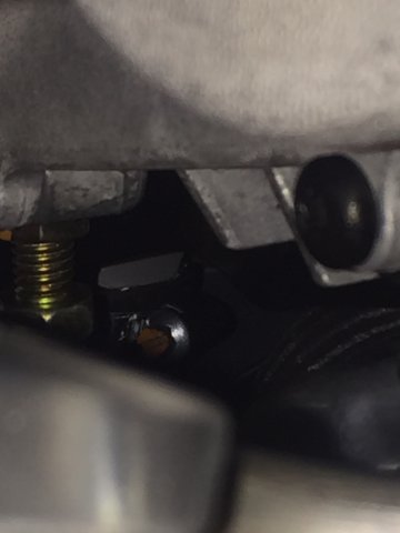

My chaincase tensioner bolt seems not to have enough available threads showing, It came from the dealer/factory and I did not adjust the chain tension as of yet. There's only 6 threads showing, doesn't seem like much ? Any body else notice on there Sidewinders how many threads available it's an RTX not sure if model of sled matters.
Pstn head
Is mine the only one like this with 6 threads showing ?

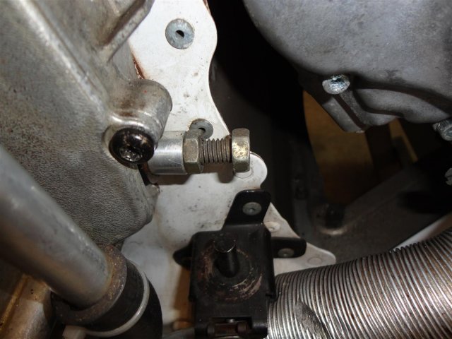

No. Not Sidewinder but here is my Vipers. 8800 mi like this. Lot of adjustment left. You are fine. Finger tight then 1 1/2 turns back.Is mine the only one like this with 6 threads showing ?
Sidewinder is finger tight and 1 1/2 turns back. Edited first post.
Pstn head
Thanks cannondale27, saw that also in my manual says 1-1/2 turns out, was at the dealer today checked out a Sidewinder there and same thing about 6 threads showing, all good.
