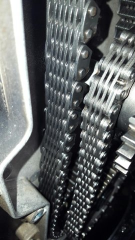

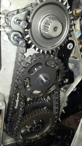

Yamaha/Hyvo gears and Borg/Warner chain like the apex? Wich drive belt is it using - same as apex or viper? Is there a updated chain case that ar solid mounted?
I have to ask - I have been away from Yamaha turbo for a while, but are really condsidering the new sidewinder mtx 162".
I wish Yamaha could give some more info on the motor mounting, secondary shaft, chaincase, gears and chain. After reading about the AC 1100 turbo blowing belts. This is the only thing I need info about before getting one. Yamaha has done all one heck of a job with this turbo setup

Its not a Cat,it has beefed up chain and gears 15 wide,still no drain plug for chaincase,but that not a game changer for me. The Viper never has had that POS cat TCL set up,the ones all us guys with our cat turbo's had to change out to keep a belt on.Way better clutching,brand new motor been developed for the last 5 years,makes more hp than Yamaha went out on a limb and stated,no lag because no blow off valve,they now recirculate the pressure back to the motor by an air bypass valve,so you don't hear that funky sounding hissing noise every time you chop the throttle any more,that was irritating at times,and because of this devise they now have zero turbo lag,but three intakes helps also,something no one else has ever done to a turbo on a sled.Yes it does doesn't it!If only for the FUN (and grin) factor.

Its using the viper belt the one that lists for 84 bucks.Yamaha/Hyvo gears and Borg/Warner chain like the apex? Wich drive belt is it using - same as apex or viper? Is there a updated chain case that ar solid mounted?

is chaincase in the sidewinder same as Arctic Cats ZR9000's 2016? cause i know one or two that blew them...
You sure they were 16's? Haven't seen that myself. They did go to wider chain and gears on Sidewinder. Wobble bearing was still in 16's and I believe it's still in Sidewinder not sure on that though. The big difference is no TCL and way beefier rear engine mounts. When cat decided to tie the engine and Chaincase together it put stress on all the bearings and shafts. Sidewinder and Viper do NOT have that TCL.is chaincase in the sidewinder same as Arctic Cats ZR9000's 2016? cause i know one or two that blew them...
