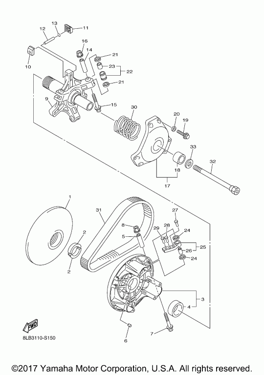

Yamaha messed up on the assembly. There should never be an o-ring slider on the torque side of the spyder. This breakdown shows correct, (but have seen breakdowns showing the other way from 2008 ...which is wrong).

Which are the part(s) in question, the "o-rings"? 10 and 11?Yamaha messed up on the assembly. There should never be an o-ring slider on the torque side of the spyder. This breakdown shows correct, (but have seen breakdowns showing the other way from 2008 ...which is wrong).

Yes, o-ring 10 and o-ring slider 11Which are the part(s) in question, the "o-rings"? 10 and 11?

Both are listed as "sliders", at least on the Partszilla site. I'm so confused.Yes, o-ring 10 and o-ring slider 11
