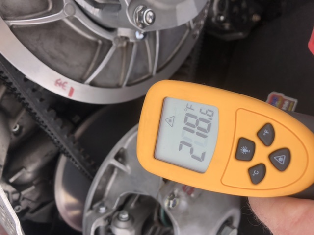

This is way way too hot!! Only one hard pass in the deep snow too!
218 belt temp. And I also corded the belt on this one run.

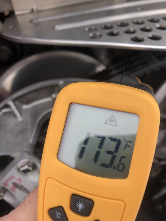

173 secondary temp.

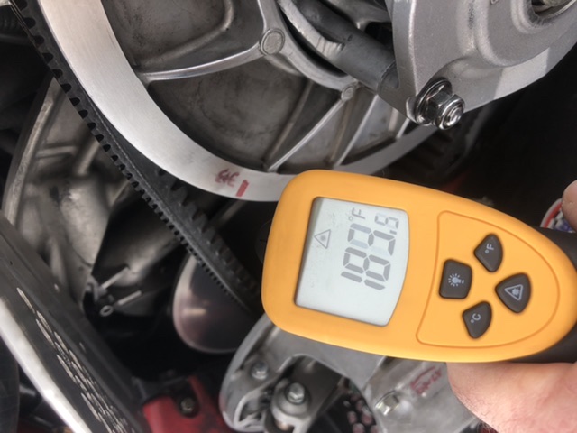

View attachment 152084Agree the temps you had a few days ago,as mentioned 145 belt,pri 120,sec 90 those are almost perfect,but these new temps very bad,and I to have had temps where you were today mike.
183 primary temp.
