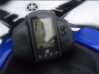

here are my Top Speed Runs 114mph/183km @ 9030 RPMs(110MPH GPS) Generaly 4-5mph behind a fast Apex GT
Sorry for the shaky film I was holding the camera with my left hand, weather was a warm +6c ,43F , Stock 2009 Yamaha FX Nytro XTX 144" Track with 114 Studs, Bergstom Triple Points, with a 265lbs rider abord, conditions were sloppy almost like a slusy....quarter tank with 87 Octain
FIRST RUN IN MPH: http://www.youtube.com/watch?v=oWBGkB_mCa8
SECOND RUN IN KM/H: http://www.youtube.com/watch?v=qJMwib1XzCw

I see you have an Ulmer clutch kit, how exactly did it change your stock machine? Glad to see those speeds for you guys, I know a guy who seems to have a slow XTX and it's driving him nuts..
