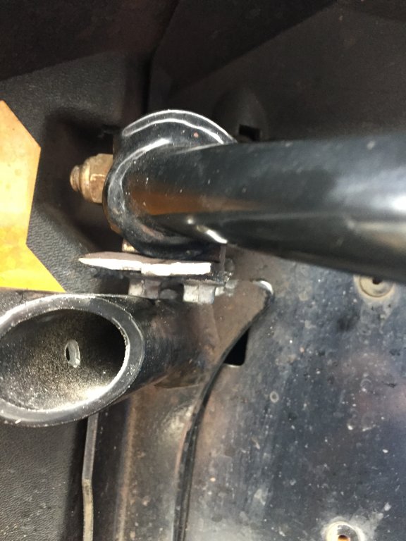

Is it still not blowing fuses? Could water be getting into something like ignition switch? Seems like sitting in trailer it has had a chance to dry out and the concern goes away?Guess what. Still in trailer still hood on, Still being careful not to move anything. It now quit blowing fuses and runs fine. Had MtCooler over to show him the fuse blowing. Would not blow one but he spotted this!
View attachment 147569 View attachment 147570

Still runs fine as of last night which did not go below freezing but close. All other tests where fuse was popping it was below freezing. So thinking temp may matter. Hood is still on so in first episode where I thought removing hood cured it. It must have just been coincidence. Was in shop when removed hood so warm. I am now in guessing mode and replacing components. Voltage regulator and Key switch will be first.Is it still not blowing fuses? Could water be getting into something like ignition switch? Seems like sitting in trailer it has had a chance to dry out and the concern goes away?
New bulkhead coming. Oh yeah it will be reinforced. Hoping to tie both sides together.I would put it back in place and put a plate on the inside and make it to the bulk head.
Several years ago had a similar problem on a SkiDoo blowing the brake light fuse over and over. Dealer could not fix. Finally found water in fuse socket. Dried it out and solved problem. Hope that helps.
OK went out to trailer this morning. Well below freezing and careful not to bump or touch anything Ignition fuse popped instant I turned key to on position. So Temperature related for sure.

Holy Cow the Magic wand says the short is in the handlebar harness! Loud tone right there. Took 5 minutes! Cobra if this is it I owe you big time!
I have some shocks to do and then will bring sled in shop and dig into that harness. Have not checked that one till now. Might get my 100mi yet this year. April ride Mr Sled?
