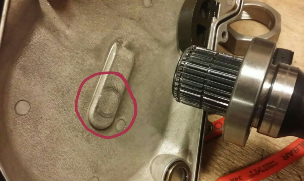

I'm worried about it putting stress on the clip that holds the lower bearing in the chain case. Dealer is selling me a new shaft at cost so I'm just going to replace it this time. If it happens again I'll come up with something better.
Don't worry... The stress is on the chaincase cover...
Maybe a shims behind the bearing in chaincase?
Lord Have Mercy!Don't worry... The stress is on the chaincase cover...
Are the magnets still intact? Cripes all this could have been figured out with a tape measure at factory!Don't worry... The stress is on the chaincase cover...
- 8,042
- 2,133
looks like the snap ring streched in both shaft pics i see. might have to replace them if you can rotate them in the groove with a screw driver. seen this lots on transport camshafts when the snap ring is re-used too often.
Remember the Old Yamaha Forward clutches like on Phazer? Still thats under spring pressure. For the disc to take out snapring like that the Caliper must be pushing on it more on the inside pad. Look carefully at Caliper. Bet you find grooves. Mine was covered under warranty.
None of that accounts for the magnets hitting cover of chaincase. Wow just Wow. They measured wrong.

When i said my machine shop I ment equipment that I have access to. I'll finish it in the morning and post some more pictures but it's not coming apart any more.

That's what I was talking about. Put a little loctite on that bolt when it goes together and forget about it.
Nice job! Now I have a project.

The plug will need welded in but pretty straight forward. I might be willing to do this as a service for people if enough people are interested. I would need to work it out with the site and would need your drive shaft mailed to me. It would be quick turnaround though and would be worry free afterward. I could probably do it cheaper than a full replacement drive shaft.
You are still letting disc float? If so press fit in shaft with aluminum would be more than enough.The plug will need welded in but pretty straight forward. I might be willing to do this as a service for people if enough people are interested. I would need to work it out with the site and would need your drive shaft mailed to me. It would be quick turnaround though and would be worry free afterward. I could probably do it cheaper than a full replacement drive shaft.

I don't think the disk floated before. If you have to ratchet strap the tunnel together to get the clip on then there is no float. Am I missing something? I was planning on shimming the outer collar till everything just tightened up an calling it good.

Both parts are steel by the way.

I'm pretty sure that is machined like that for the pickup. I've had a few apart and they all looked like that.Don't worry... The stress is on the chaincase cover...
Mine floats slightly.I don't think the disk floated before. If you have to ratchet strap the tunnel together to get the clip on then there is no float. Am I missing something? I was planning on shimming the outer collar till everything just tightened up an calling it good.
