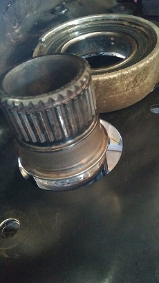

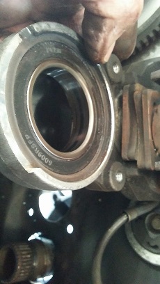

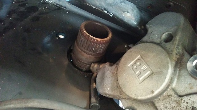

Here's mine...
Both machines received a Driveshaft Saver at seasons start.
Wedge installed flush at 40ftlbs.
I Did Not check to see if the bearing was actually locked onto the shaft.
Just torque and go.
Machine #1
At 4500 miles wedge was installed.
2900 miles since install.
Still spinning.
Machine #2
At 2400 miles wedge was installed.
150 miles since install. Wife did not get to ride due to a non-sled related injury.
We can see that the wedge was "trying" to help, but shaft was already too far gone.
New driveshafts & bearings, for both machines will be coming shortly.
My thoughts are this...
-These driveshafts spin from day one
-Driveshaft Saver will only work on New Driveshafts & Bearings
-Driveshaft Saver May work at 1000 miles or less. Test, don't guess.
I feel the Barn of Parts Driveshaft Saver is a good solution to prevent the bearing from spinning on the shaft.
But the shaft has to be essentially new.
What are your experiences and observations?
