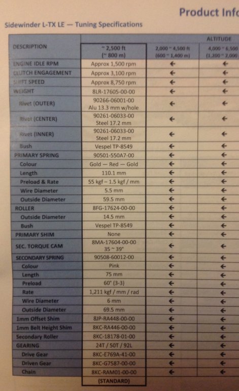

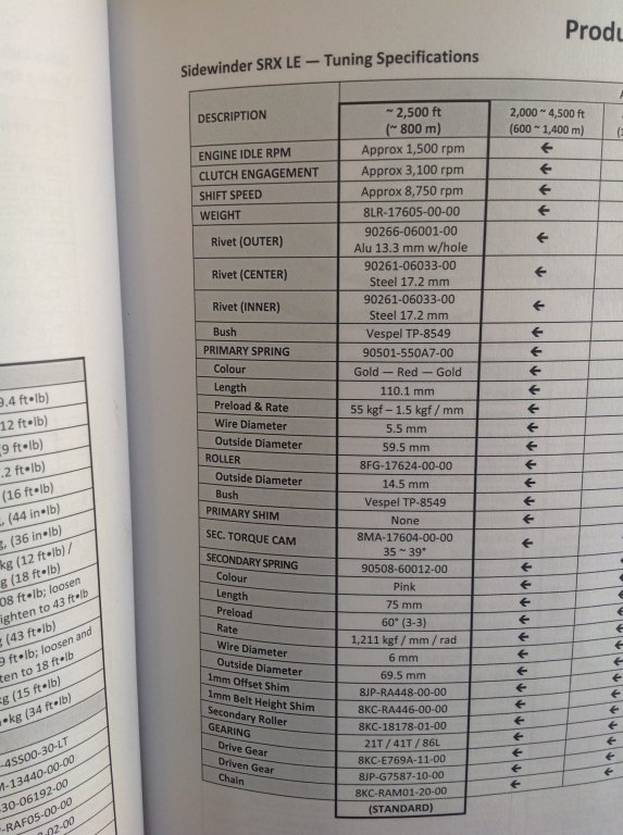

Correct me if I'm wrong, but I thought the 2020 Winders came with 24-50 gears in it, all but the SRX which had the 21-41 in it yet.

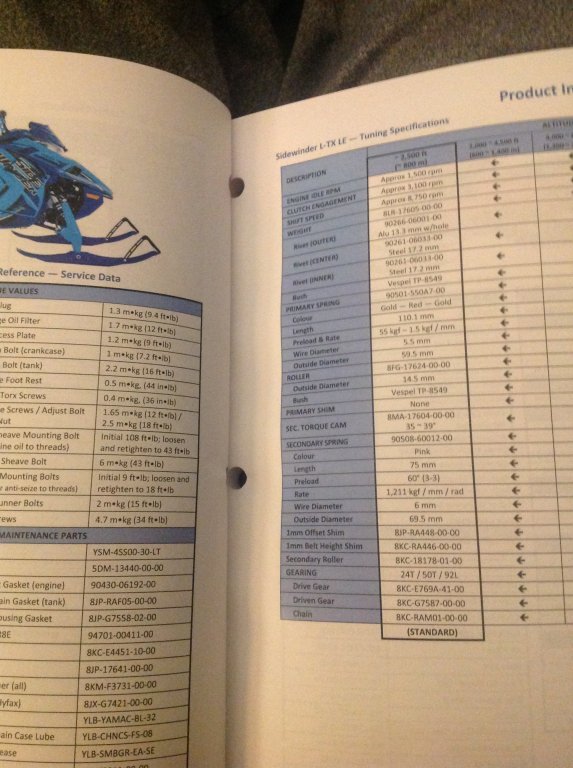

Mr. Knapp 2019 LE’s came with 24/50 gears. 2020 LE’s came with 21/41. I’ll take a pic of my ‘20 service manual and post when I can.

Yes, your top speed should be higher if you are running in good conditions. Your sled with stock gearing is capable of 124-126 GPS, which is usually higher reading on speedo.

Yes, but the 20 LE is 21/41 according to online parts fiche.From the 2019 book le is 24-50 , srx is 21-41

My 20 se had 21/41. 19 le with 1.6 track had 24/50 that’s where I ordered mine from

From the 2020 manual srx 21-41 , Le 24-50 , Se 21-41 , Xtx & BTX are 24-50

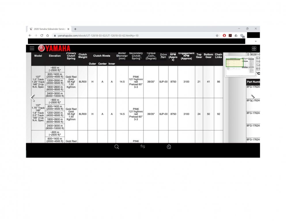

Can you take a picture of the cover of the manual you pulled that from? I have an online manual from Yamaha (screenshot posted) and a hard-back manual I paid $75 (!) for from Yamaha showing that 137" models with a 1.25" track have 21/41 gearing. Apparently there's also a 137" 1.75" model geared at 24/50.
