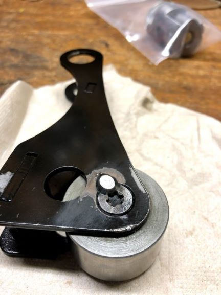

Had them lock the bearing behind the break rotor with bearing mount compound from prematex. Also welded the chain case tensioner roller screws and I installed an mbrp pipe which has hex head bolts rather then the Allen head factory bolts at the turbo.

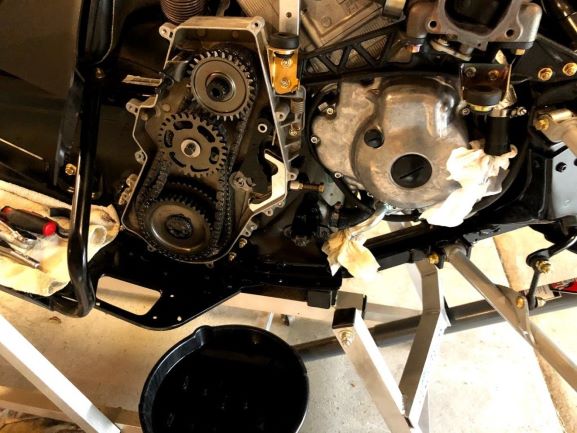

seems like oil leaks are a very common problem, I was told the tank is warped and they are putting on a new one. I haven't seen my sled in over a month...Covid and diagnosis being the reason for the slow fix. Glad this didn't happen during the season...The dealer has been good about keeping me informed.
What does baffle me from what I read here on this thread is that the chain tensioner bolt needs welding...I'm not a mechanic but can someone explain why this needs to be done and if the bolt eventually needs to be replaced is it as simple as taking a grinding wheel and cutting out the weld?

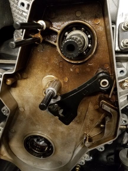

On many sleds, the screws that hold the chain tensioner wheel into the bracket come loose and fall out. The screw can then go between the chain and the gear raising holy H*&%! Also, if both fall out, then the whole wheel falls down into case and gets wedged between lower gear and case thereby breaking the bottom of the case. Game over! Big repair! If you don't have access to a welder, at least clean both the screws and the threads in the wheel and red loctite them.

Thanks Turboflash, I get it, I will contact dealer as they still have my sled and while chain case is open maybe they can weld the bolt or locktite it. Thanks for the clear explanation. JoeOn many sleds, the screws that hold the chain tensioner wheel into the bracket come loose and fall out. The screw can then go between the chain and the gear raising holy H*&%! Also, if both fall out, then the whole wheel falls down into case and gets wedged between lower gear and case thereby breaking the bottom of the case. Game over! Big repair! If you don't have access to a welder, at least clean both the screws and the threads in the wheel and red loctite them.
