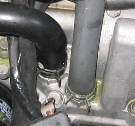

Are you sure that you have the two larger hoses that come from the oil tank on the right fittings down in front of the motor. One hose is black and the other is grey and if they are backwards you will have problems like you describe. I did it once and that's what happened, Ken.

Here is a picture of when I removed it, I installed it the same way and I remember I double checked it and I remeber thinking they were different size hose and it would be hard to cross them. I may take apart in the intake system again and see if I can get back in there to make triple sure. All my time was working on it late at night after a 12 hr day so I coudl have still screwed it up. Thanks

Thanks wheelie I just took it apart and it is connected as in the picture pheww :drink:

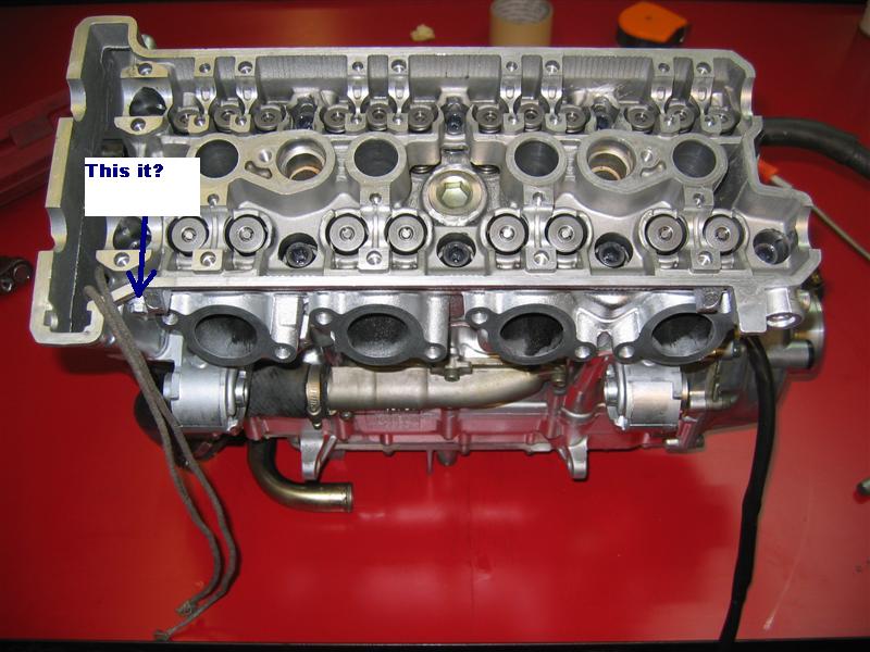

I cannot find that bleed bolt anywhere near the back of the head but I did find this thing protruding out the front side of the head on the clutch side looks like a possible bleed bolt?

That's the chain tensioner above the crank case breather. The bolt you are looking for is on the back side of the head beside one of the exhaust outlets.

I suppose that bolt is impossible to reach when the tank is installed? Both Paul and I couldn't see a thing in there unless its under the heat shield that covers the flex pipes. IN which case I will need to remove the gas tank to reach that, those two bolts way in the rear are impossible to get to with the tank installed.

Sorry you got the right pic this time of the bleed bolt.
I wonder if you take the bolt out of the sheild on that side, if you can pry it up enough to get to the bleed screw. I sure hope your dealer didn't put a plug down the oil tube to stop oil leaking, and forgot to take it back out. I sure wish you lived closer, I hate these kind of deals. Keep after it, you'll get it. Maxdlx
I pulled the bolt for that heat shield and it will not pry up at all, it actually wants to go down more then up. I'll call them on Monday and talk with him. I'm almost wishing it was something definitive so I can get it fixed, not knowing is almost worse then knowing I have to pull it our again! (Ok maybe not...)
