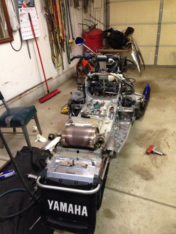

I'm doing the wifes 2010 RS Vector LTX. I did my Attak's 4 different times. My hanger bolts came off ok..the donut clamp hex bolts started stripping. I used a map/oyx combo from Home Depot to get the bolt cherry red and a vise grip on the head and they loosened fine.

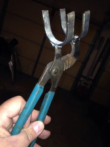

I am at the point were I tried to use the Channel Lock to compress the flex pipe but there isn't enough room to get the copper donut in. I have the silencer and y pipe still connected and pulled back as far as I can get it too. I tried to get the flex pipe off the head but the bottom bolt is a challenge. I don't seem to have a good wrench or socket to get in there. I figured I could of taken them off.
So I now have to drill the rivets? If I remember on my Attak I had to remove the flex pipes to be able to slide the ypipes ahead to get off the bracket. So unless I can find a way to loosen the bottom bolt on the flex pipe I have to remove the rivets. Right?

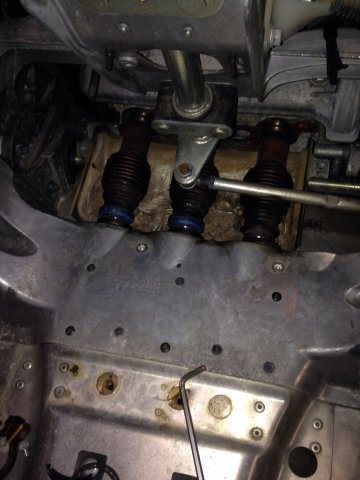

I got a small wrench on the lower head bolt. Then took a long dowel and gave it a wack to free it up. I cut away a strip of insulation under the bolt so a small 1/4 in socket will fit for installing. The flex pipes came right out fine. Is it safe to use the same head gasket again? I thought I read you could.
Again before anyone trys to free up those clamp bolts they should heat them cherry red. And also the hanger bolts before trying. That kit from Home Depot with the Mapp gas and Oyx gas is great for that. It can give a small hot flame to surgically hit the bolt or nut.
UDATE.
In putting the flex pipe back on etc. the silencer disconnected from the ypipe. The y pipe seemed to go back further this was so using the channel lock method of inserting the donuts might work on these Vectors. To get the silencer hooked up again I lubed the inside of the gasket with grease and dropped the upper wheels so I could see the line up. Easy enough. Wish I tried that at the beginning.
UDATE.

This procedure explains how to replace exhaust donuts in a 2006 RS Vector.
1) Seat Removal:
--remove rear exhaust trim in order to access the 2 seat J-bolts.
--remove the 2 J-bolt nuts then lift rear of seat.
--disconnect the tail light plug (front RH side of the seat).
--remove seat and set it to the side.
2) Tank Removal:
--disconnect the two fuel lines on the front RH side of the tank. Gas will drain from the lower delivery line so either drain the tank first or use a short piece of 1/4" fuel line to jump between the upper and lower tank nipple.
--disconnect the fuel sensor plug on the front LH side of tank
--remove handle bar pad then unbolt the 4 handle bars bolts (12mm socket).
--remove gas cap and black rubber fill neck ring
--remove the 2 knee panel bolts (phillips head) and the 2 nuts at the rear tank mounts (12mm socket).
--lift the plastic tank cover up over the fill and swing it and the handle bars around to the front.
--disconnect the vent tube located in front of the gas fill.
--replace the gas cap then lift the rear of the tank over the mounting studs and slide it back. Remove the tank and place it to the side.
3) Exhaust Repositioning:
--unbolt the 4 muffler bolts (12mm socket) and the 2 front muffler cover bolts (10mm socket)
-- remove the black rubber tunnel plugs to expose the 2 front exhaust hanger bolts. Remove the bolts with a 6mm allen socket. (clear any debre out of the cap so that the socket fits securely. If the bolts will not turn tapping on the socket with a hammer or using a hand held screw impact driver may loosen them.
-- remove the 4 exhaust manifold cover screws (10mm socket) to expose the 3 donut clamps.
-- with a 6mm allen sock remove the v-clamp bolts. The clamps are normally loose enough to rotate them up so that they can be sprayed with penetrating oil before removal.
-- with the clamps removed slide the muffler back. It doesn't move far and will not give enough clearance to replace the donuts so a large pair of channel locks pliers will be needed to compress the flex pipe. With the flex pipe compressed there should be just enough room to get the new donuts in but be careful not to damage the pipe or new donuts.
Note: Removing the flex pipes may be a more desirable method to gain access to the donuts. It also allows for thorough inspection of the pipes for cracks.
