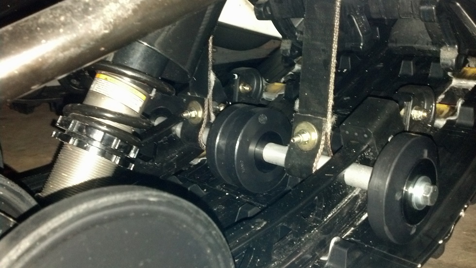

Studroes144
- Oct 30, 2013
- 2,897
- 956
- 973
- Lowville, NY Tug hill snowmobiling
Very nice looking setup Tim. Thanks for the pic!
