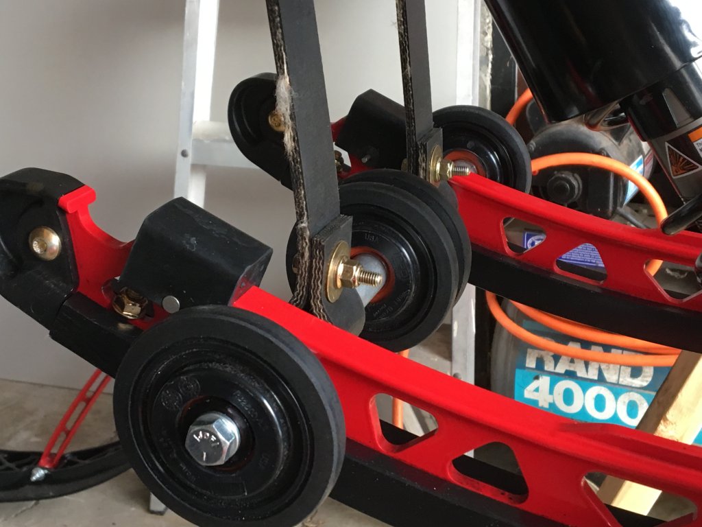

Thanks, I got the 808 kit this week and added to the inside of the skid, perfect fit. Also just received the Wahl Brothers wheel kit also, went with 3.25 rubber wheels, nice kit. Have to let them know you want a custom kit not the standard quad kit.

Page 4 of the thread has a photo that Yamahatim posted. The kit replaces the limiter strap shaft. I went 3.25 rubber wheel. Cannon I’ll text you a photo to use. I can’t seem to get it to work. Also note you will have to drill out the bolt hole for the larger bolt provided with the kit.

That is slick! I don't get much slide wear but when I do from running ice or low snow that should cover the only area it happens. Way back I tried the Hyfax saver wheels Yamaha has always offered. Real small dia and broke one right away. These are a much better design.View attachment 135013 Did install this morning, you will have to drill the skid holes larger, 7/16 bit was what I used.

You have to asked them for a custom quad kit to get the 2 outside the rail wheels. I ordered wrong kit first time, I called and told them exactly what I wanted and was all set. It’s a 2016, LTX-LE. They have 2 options for wheels,plastic and rubber. See page 4 of thread, YamahaTim has photo of his also.
