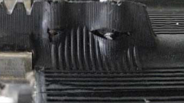

This is what I ran into running screw in studs. Due to the sharp point at the base and track lug flexing the point of the screws tear through the track. Like I mentioned before less than 2500 miles on a Doo 600 track and it was not looking good.
I would not recommend unless on a low HP sled.

I will keep that in mind but this is a completely different product and the track style has a ton do with if the track can with stand the wear and tear.

Do you have pics of product before install....Does it have a sharp starting point ?
The reason for success for camoplast/camso on their ice tech tracks is the smooth base all the way to the belting.
I wish you the best of luck.

I did this in an 1 1/4" lug track , and had none of the tear thru as in the pics .I will keep that in mind but this is a completely different product and the track style has a ton do with if the track can with stand the wear and tear.
Various brands of these studs have different length screws , for different height lugs .
the worst that happened to me was some studs that come out , but no lug tearing .
