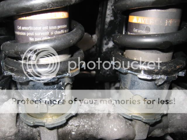

Here is what I know, I THINK I was riding most of the day with the preload set on 4 or 5, it was however it came from stoutner(the guy I bought it from). At the end of the day, I ran through a rough trail section and it bottomed out pretty easy on drop outs where the trail just drops about a foot or so and then 4 feet later comes back up to where it was. If the suspension had a front shock(I know it doesnt) it feels like the front shock was bottoming out. If the bumps hit the rear of the skid, things were fine and dandy(to much coupling?). After running through that section, I cranked the preload up one notch and ran through it again. I could tell it was slightly stiffer, but again it bottomed out pretty easy on the big hits and G-outs, just like it did before the adjustment. I didn't fool around with the revolver at all. I will check the manual and make some changes on what I think I should do. But do you guys think? I know this suspension can take the big stuff I just need some help tuning it.
Here are some pictures of it current setting, I believe the preload is on 6,which is what I switched it to yesterday when riding as described above.

You bought this skid used or new? Does it have dual or strait rate springs? The ZX2 is usually very hard to bottom out---I bet I haven't bottomed mine out 10 times in 3000 miles, and it really shines in the G-outs. Makes me wonder if your shocks are spent?

What do you weigh? I set mine up per the manual for my weight and riding style and never bottom'ed out. Try that and report back.
tkuss
I only weigh probably 190-200 all suited up. So I belive I did the preload set for my weight. Hopefully this next weekend I can get some more riding time and try cranking up the preload as high as it can go. And if I bottom that out, than I know something is wrong, or not like it is suppose to be. Like I said before, the ride was very nice, just didnt handle the big bumps like I thought it would.

I had mine on 3 and could not bottom it. I am abt 230 with gear. I have it set on 5 now and ride is great through everything.
Sounds like what STAIN said, shocks.....
If you push down on the back of the sled, the suspension should move very little. I can stand on the rear of the running boards and jump up and down, and the suspension barely moves.
What kind of sled, and did you use the correct instalation kit?

Here is your answer: Tighten your track.
You will be amazed at the difference.

The shocks should be just fine....at least I never noticed any problem when I put the sled away last Spring. Was the bottoming out "harsh" or did you just hear your track hitting the tunnel protectors? I weigh 240 and it rarely bottomed out on me....but, The track does "flex" up and hit the tunnel protectors very easily because of the limited clearance that we spoke about. When your track is on the looser side, you will get that pretty often. It will be less often when the track is tighter but it will still happen.

How much sag do you get when you lift up the sled and your track is hanging there? I didn't even have 1/2" last year.

I think this track relies on track tension to keep suspension sag to a minimum. Before tightening your track, measure the sit in/suspension sag when you sit on it. Then measure the sag after you tighten the track. I bet you there will be a huge difference.

Dennis at AD Boivin recommends lowering the front end by lowering the Fox Floats to 25-30 PSI. I don't think I want to go that low but I will defianlty lower the PSI. I am at about 60 psi right now and will lower to 50PSI and then keep lowering in increments of 5psi or so if the ride gets better. I will also tighten the track tension up to about a 1/2 inch of sag or so with at outside temperature. Hopefully these things will make a difference.
