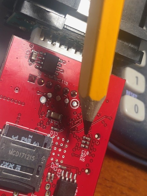

I opened the flasher to look for corrosion, none found.
I wonder if these 2 connections are broken? I don't really want to make a connection there if it is not meant to be for fear of frying something....

upon further inspection, I don't that is my problem. I think I may be screwed. I am not sure I want to shell out another $550 bucks for another flasher.
