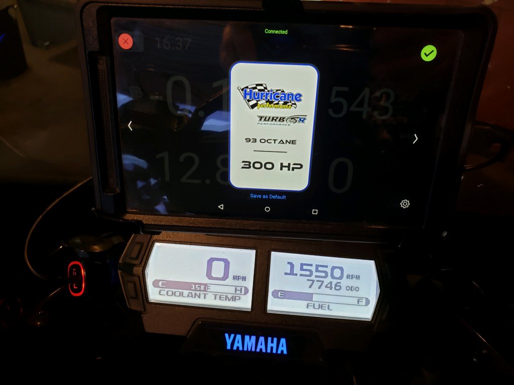

I put a piece of electrical tape over the computer cable port to keep moisture out.
I leave mine plugged in while riding.
I Bluetooth it to my tablet and use the dashboard to switch tunes and also look at the sensor readings. Nice big numbers.
