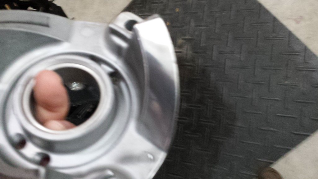

IM wondering if the rough of the helix COMBINDED with belt dust is stopping the roller TOO SOFT momentarily and thereby causing the flat spot..
one pic is stock with pretty much zero miles...second is ramps polishedView attachment 124287 View attachment 124288
I would think the rough cast surface would grab the roller making it roll....instead of possibly sliding on polished surface.
from the friction ...like sandpaper? I hope the smooth like glass is a better option...it always worked well on the button clutchs in the past...
- Apr 14, 2003
- 6,539
- 3,172
- Hessel, Michigan
Buttons....yes,...less friction the better so polishing with new buttons is awesome. But you want the rollers to roll....not slide on the smooth surface.

Ever think it could be possible for the rollers to have dent from slamming into helix? I know that will take out a button real quick and sometimes can't really be avoided such as a hard braking then accelerating incident.

Yup. Also the Yamaha rollers are pretty narrow. Just pulled mine tonight. They seem very light weight material. I had like 2-3 small flat spots on each. A fair amount of side to side slop also. BUT you do want a little. I have Cat ones going in. I have three older ones I put in to compare. New ones might be here tomorrow.Ever think it could be possible for the rollers to have dent from slamming into helix? I know that will take out a button real quick and sometimes can't really be avoided such as a hard braking then accelerating incident.
stone88
Okay excellent pic! That is wear not a dent. Roller was not rolling but sliding without a doubt. Can see the lines. Now question is did a dent in roller prevent it from rolling resulting in that? Safe to say they are too soft either way.View attachment 124317 Checked My clutch last night and after 500 miles this is the result!
stone88
Definitely to soft it might as well be a button clutch at this point. I will be putting on s button clutch from my Viper to test as I don't want to run it like it is until I get s roller replacement.

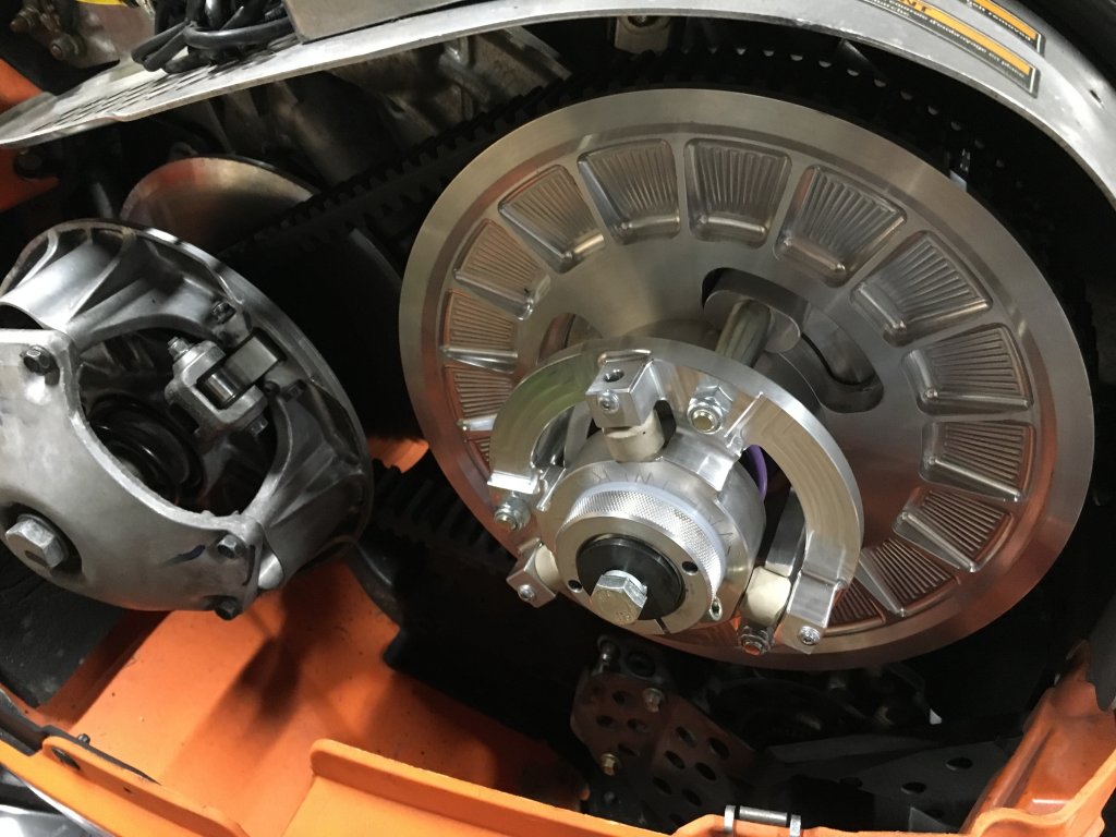

Here is your solution....
Kevin
- Dec 20, 2006
- 843
- 272
- 1,208
- Ottawa Canada
- Sidewinder
what the hell is that?Here is your solution....View attachment 124332
LOL
