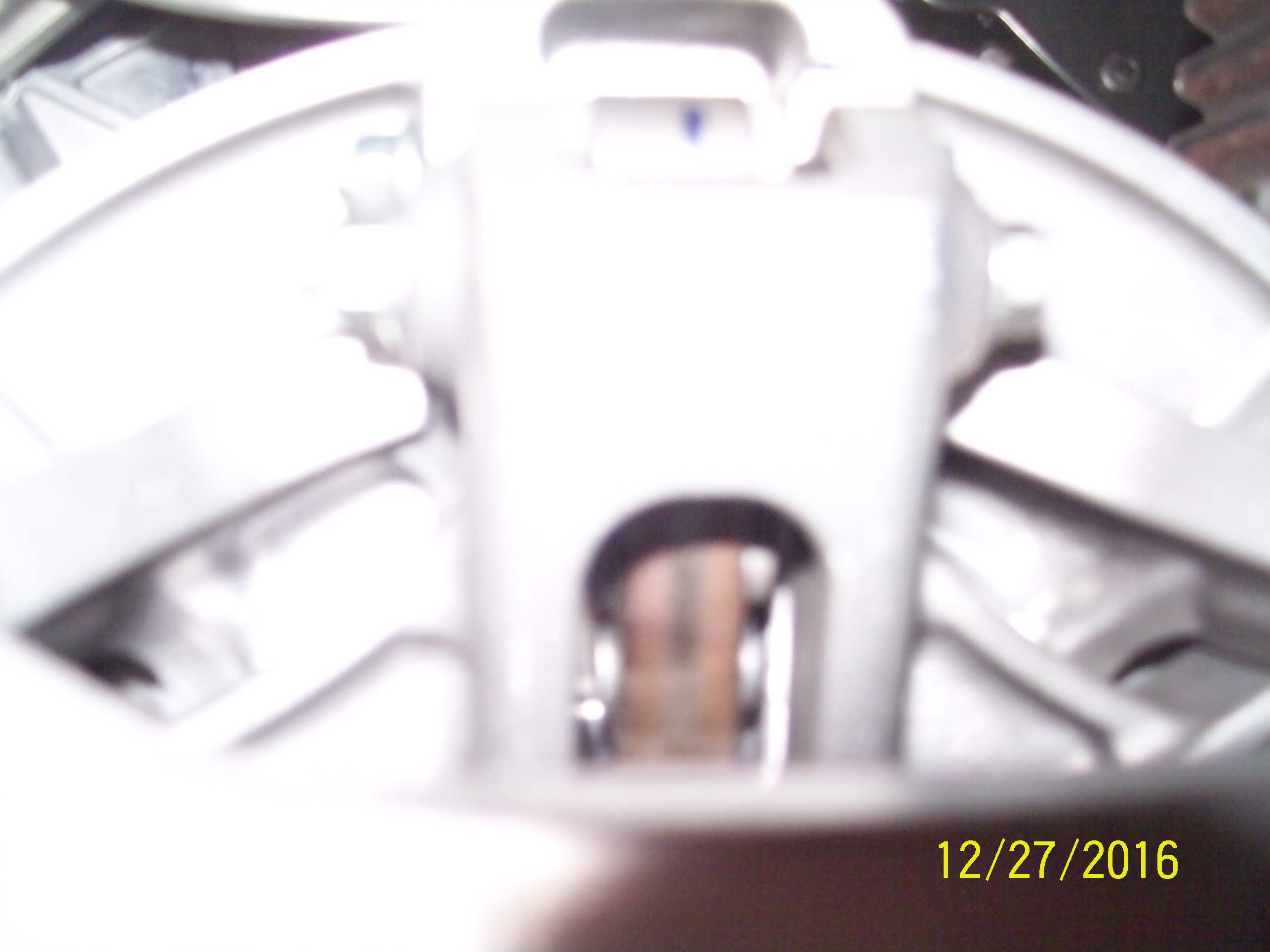

Perfectly normal most my other yamahas looked the sameheres some pics, primary roller and arm. look normal anyone?? all look about the same.

Try clicking INSERT IMAGE before posting to see if your photos will show up instead of being downloads.heres some pics, primary roller and arm. look normal anyone?? all look about the same.

aj said "Try clicking INSERT IMAGE before posting to see if your photos will show up instead of being downloads."
thanks for the tip, will do. i was happy to get them to go as i have seen others have file too large issues, including me when i tried to load avatar of my son and i in maine. i still use a flip phone...and only bought an i thingy (how the freak do you work this@#$%#@$#)to listen to music when sledding...
