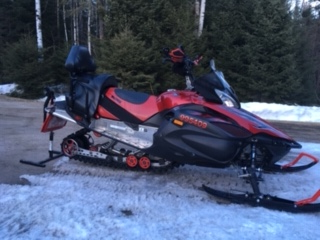

Just purchased a 2011 Apex SE with the Fox Mega shock in the rear skid. I also purchased a SeatJack for my wife to occasional ride with me. I have been looking for weight and air pressure chart to set the rear air pressure when riding two up?
Has anyone ridden two up, and if so what did you run for air pressure in the rear shock?
