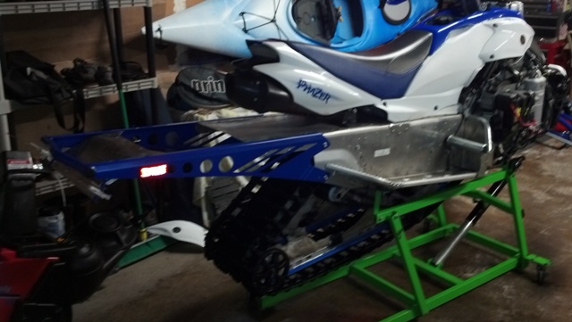

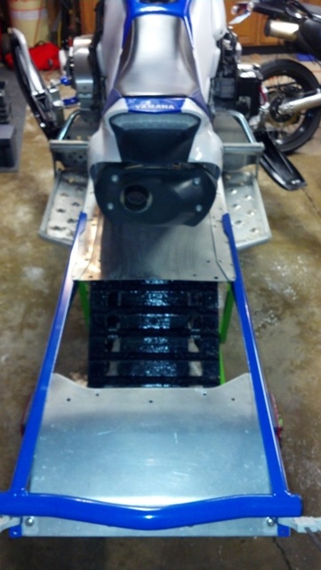

Ok ok, so we got home from the Muni ride at 4:30 AM this morning. This afternoon I dragged the Phazer off the trailer and into the garage. The Muni snow hasn't even melted in the skid yet and I am tearing into it :)
I already have the track and rear bumper for the stretch. I need to order rail extensions, fab tunnel extension, send my clutch weights back to Ulmer for some massaging, and look for additional rear wheel mounts.
G.B.

Holy cow you dont mess around!Looks awesome.If the track doesnt do the job just close the front hole.
cannondale,
Yeah, I was pretty frustrated this past weekend and just wanted to ride. Although I am wondering if the 1.25" Predator track I am going to put on will help the cooling issue that much? It is only 0.25" taller but does have more of a paddle style lug tham teh stock 1" ripsaw. I sure hope it does. I didnt realize you could close off the front hole on the tunnel. I thought people were only closing off the rear hole. Mine is an 09' which has the factory closed hole in the rear but the front is open. Is there any down side for closing off the front hole in the tunnel?
Thanks, G.B.
I have a 2007 FX and I have both the front and rear holes closed off and have never had any icing issues or other issues because of the closed off holes. I am running the stock 1" track. The only thing that was recommend was to modify the front deflector plate by cutting the sides off by about an inch to allow air to pass thru under the seat and cool the exhaust off. It also keeps your legs nice and warm too. Almost like arctic cats heated seat.
Yamaha claims excessive heat will substantially reduce the life of flex joints. Given that they are underneath the fuel tank, closing the forward opening in the tunnel could literally be playing with fire.
There is risk involved but I have thousands of miles with no issues other than the heat shielding fibre disintegrated last year.Have seen that on stock ones also though.Your call.
