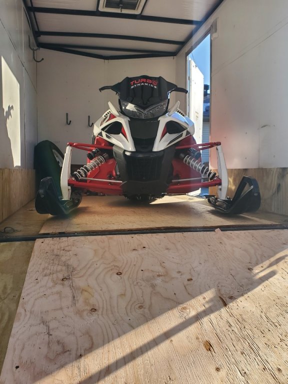

Ready to rock! Should be fast tomorrow!

Something is wrong with your shocks!
Low=fast.

Looking forward to hearing about your results!!
Good luck man!!!

Looks fast!
RAMSOMAIR
Yep, gotta slam it to get speed!

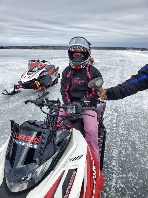

Great day on the lake. Big crosswind today. Best my 220lbs could do today was 128.8 on the stalker which was 128.54 on my dragy.
My sled hit my goal of 130mph in 1320' on pump gas with a lightweight driver. Man can she ride a sled!!
Overall pretty happy to where I've got this sled too. Big thanks to the Whitson Lake Boys for helping me reach my goal.

Right on.
I don't think it's the weight. She's probably just a better driver.
