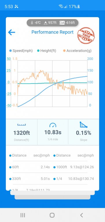

Hit 2 season goals I set for myself today.
1st was 130mph in 1320 with me on the seat and 2nd was 140mph top speed.

So were you also able to out run your bud on the blue winder ?Hit 2 season goals I set for myself today.
The ice must have been ideal , in addition to the clutching changes ?

We drag raced 3000 feet and we were 1/2 a ski apart. It's crazy how close our 2 sleds are. Totally different clutching between the 2 sleds. My buddy's speedo was reading 145 mph and my dragy read 140mph.So were you also able to out run your bud on the blue winder ?
