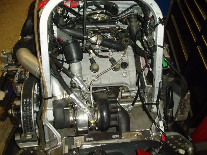

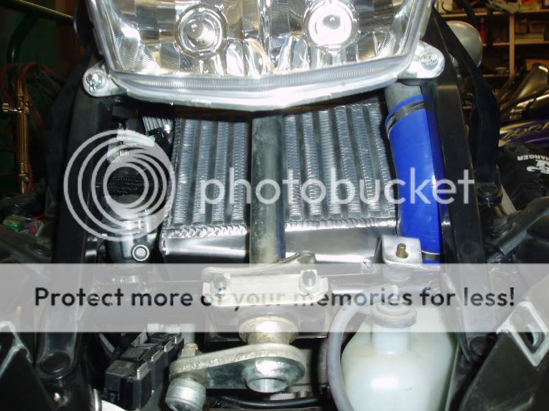

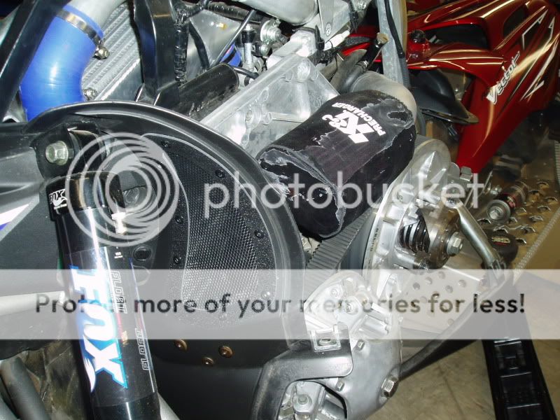

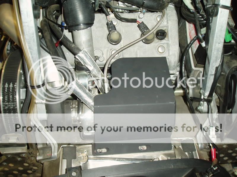

There is some photos in the turbo section as well of our 210 kit, which is the same basic components and looks the same.
