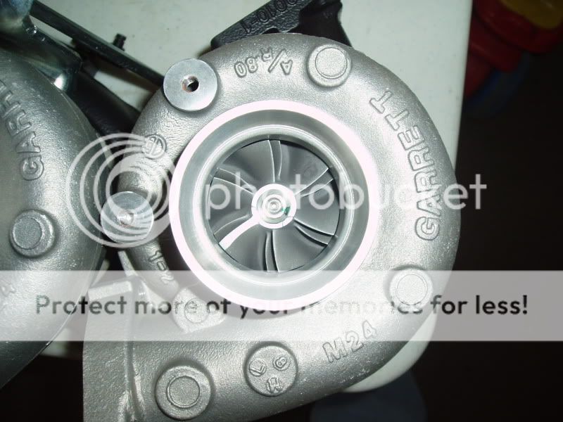

A picture of the standard GT2854R that we use in the Stage 1 & 2 kits!
A picture of the modified GT2860RS Disco Potato to be used in the Stage 3 kit!
How we did it....we started out with a center section and exhaust housing from a GT2860RS Disco Potato. Due to the intake housing on the GT2860RS Disco Potato being too large to fit in the chassis, we had to take a intake housing off of a GT2854R turbo, machine it to fit the appropriate size of the Disco Potato and we now have a Disco Potato for Stage 3 kits!
GT2854R on the left and GT2860RS on the right.

Yes, a thicker head gasket is included to lower compression to 9.6:1 and bigger injectors are included. We will begin working with the PCV autotune this fall, the PCV currently isn't available to the public, but when it is we want to hit the ground running with it.
