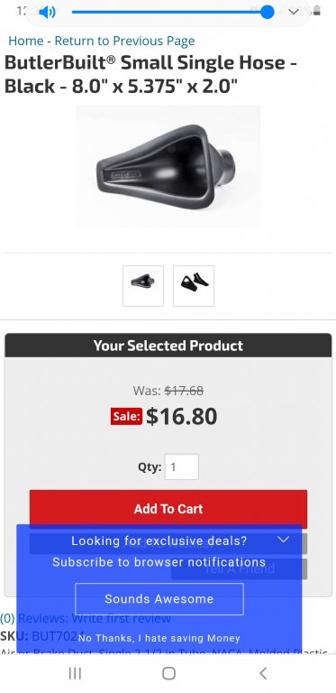

Put a naca vent on your panel with a frog skin over it routed to your airbox.
Yes something like that!
Thanks!
