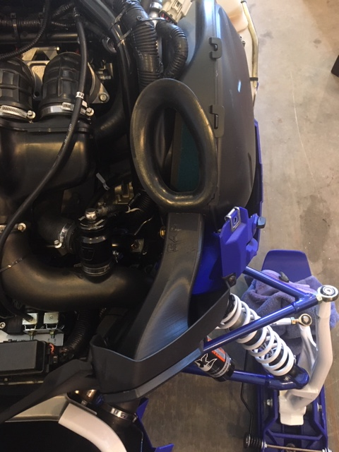

I installed this Gap intake when they first became available last winter. LOL...I can't resist these things.
I also have a full screen kit on my sled that I installed before I ever even rode the sled.
It takes a little bit of attention to ensure it fits properly but once installed it looks like a factory piece.
Does it make any difference? Who knows but probably not. I do know the sled runs very strong in all conditions.
If there is any advantage it should be enhanced by the closed loop software I installed for this season.

So are you guys blocking off the stock intake on the airbox then?
I'd imagine if you didn't it would work no better than stock for ramming air into the box. There is after all a low pressure area behind the windshield, and if you don't block that factory intake off, any pressure built up in the airbox would just backflow out that stock intake.
Ramming in the front sure can't hurt if it really builds any pressure, but the thing is the ECU is supposed to limit the boost anyway, so is there really any gain other than getting pure cold outside air? Too many questions to be answered. Cheap way is to stick the filter out the hood and let it ram its way in there which the Pro-Mods doo.
I agree ...there is no way it can build pressure in the airbox without blocking the stock air intake at the top of the air box. I did not block off the air box and have utilized it primarily to ensure the airbox receives an ample supply of outside cool air.

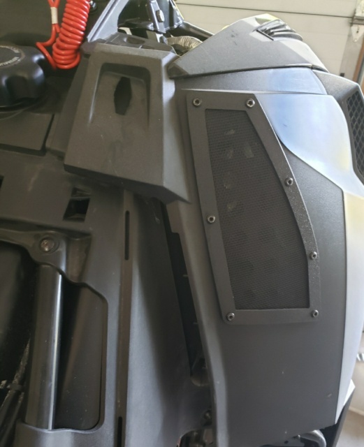

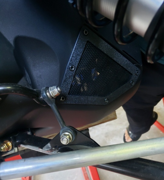

SideHogger
- Apr 16, 2016
- 938
- 410
- 788
- upstate ny
- 2017 Ltx-Le Sidewinder
Where did you purchase your venting?
yamamarc
- Sep 29, 2013
- 3,051
- 2,848
- Massey Ontario
- 2019 zr9000 Ltd
Moflow vents in the USWhere did you purchase your venting?
