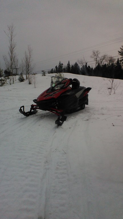

It was on a hard groomed trail on a road I very impressed with my apex

I am confused, what sled are you racing the 1200 with, an Apex or an RX1?
What length track do both of you have?
Mine is a 121 apex my friends is a 137 1200 doo with all cudney stuff header reflash muffler mod had a RX last year on GPS mine went 115 mph his went 110 mph iam must overreving a bit on top going to turn my helix as the team tied has two angles
Is yours clutched, stock gearing, stock track?
40\128 front spring 1.5 extra grams attoe 1.5 extra at heal stock gearing time tied secondary ,73\59 rear helix spring in rear is what came with my RX,1 set up starts at 10500 ends up at 10800 at 115 mph
